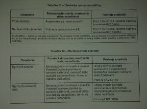

http://www.svarforum.cz/forum/uploads/thumbs/2487_stn_en_iso_17662_kalibrovanie_135.jpg
tak co k tomu dodat!
Editoval DUSAN EWE (24-02-2011 13:41:28)
