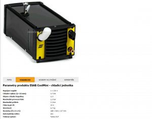

Re: Chlazeni horaku TIG
najmensia chladiaca jednotka froniusu - FK 2200 (MagicWave/TransTig 2200) - 220A max.
850W (1l/min.)/950W(3l/min.)
http://www.svarforum.cz/forum/uploads/thumbs/2227_image001.png
esab coolmini (caddytig 2200) - 220A max.
700W (3l/min.)
http://www.svarforum.cz/forum/uploads/thumbs/2227_coolmini.png

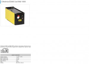

esab coolmidi (origotig 3001) - 300A max.
1100W (4,1l/min.)
http://www.svarforum.cz/forum/uploads/thumbs/2227_coolmidi.png

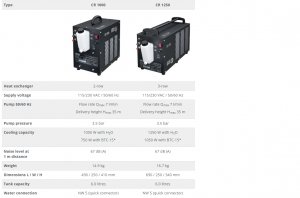

chladiace jednotky binzel
http://www.svarforum.cz/forum/uploads/thumbs/2227_binzel.png
milan asi to teplo zavara do poharov od uhoriek smile
